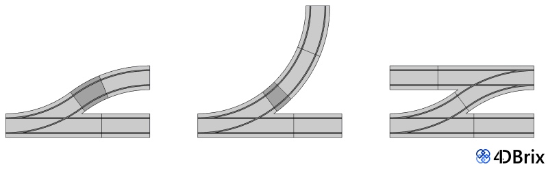

4 minutes ago, Lowa said:
You see an application of the concept below for a R40 switch, 1 switch, 2 adapters (dark gray), 3 possible uses...  I also think this is the only feasible approach to combine narrow and standard gauge.
Looks like a great solution.
This is where the 3 rail dual gauge gets tricky. You need two variations of the left hand switch to make the connection you've shown on the right. So four variations of the switch to cover all eventualities. Then again, maybe that's not such an issue when you are printing them one at a time anyway.
:classic::classic:
Edited by AussieJimbo
3 minutes ago, Lowa said:
Ok, from that perspective, that's indeed an issue.  That's the same with the monorail switches, LEGO also use a modified shape to make it work.
I haven't done the math but it's indeed makes sense that that will only be possible with certain radii.  I sort of consider the radii as 'fixed' and something we have to work with.  My idea was to make switches with a pure circular turnout section and then provide two additional 'adapters': a circular one that continues the turn up to the next circular segment, one that turns back to a parallel track and continues up to the next straight section.  That gives you flexibility with your switch - you can use it for both options - depending on the 'adapter' you connect to it.  It's a concept that is generally applicable to any switch, any radius.  You need more types of segments (= the adapters), yes, but I think that inevitable if you're expanding to a more complex track system.  We add a number on every track type we make so you can easily distinguish all the track sections.  You see an application of the concept below for a R40 switch, 1 switch, 2 adapters (dark gray), 3 possible uses...  I also think this is the only feasible approach to combine narrow and standard gauge.
We're more or less on the same page.  The only issue I'll point out is the crossovers are strictly impossible at the uneven size switches, since there's no way to put an adapter between them.  In other words, you couldn't make an R56 crossover work, unless you also want to make 2 different length straights to adapt on each end.  Realistically, I don't even think it'd be necessary anyway, so I wouldn't bother.
Here's my R104 solution, pretty much exactly what you posted:
As for the narrow gauge stuff though, the same principles could be applied, and in fact the special angles will still work out to be the same, just at different radii.  Dual gauge would be a different project altogether.  @AussieJimbo hits on it exactly; it should be done 3 rail, but you need two versions of everything, one with a common inside rail and one with the common outside.  It's doable, especially with 3D printing, but it's probably not viable as a molded solution.
Honestly, these projects could be done in tandem, but I think they're different enough that they should be kept separate projects.
