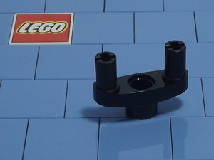

BrickMonkeyMOCs Posted August 26, 2016 Posted August 26, 2016 (edited) I'm hoping someone can help me out with an assembly here. I'm working on a model in LDraw that will use part 15461 shown here: The assembly I need is shown below. I don't have this part so I cannot check it myself. Part 15461 is in black on the left. What I want to do is insert 3L bars (shown in pink) inside the pins to connect the blue and red sections together. LDraw says this should work, but my concern is that they may not go all the way in to finish flush on the front face (and they will need to). My back-up solution is to use cut sections of flex tubing, but the 3L bars would be better. Can someone be awesome and check this for me? Edited August 26, 2016 by BrickMonkeyMOCs Quote
KamalMYafi Posted August 26, 2016 Posted August 26, 2016 (edited) I've try to use the 5L bar one and it can't go through the 15461 because the pins are shaped like this. Edit: I'm now a KNIGHT! Edited August 26, 2016 by KamalMYafi Quote
leinaud Posted August 26, 2016 Posted August 26, 2016 On 8/26/2016 at 4:00 PM, KamalMYafi said: I've try to use the 5L bar one and it can't go through the 15461 because the pins are shaped like this. Edit: I'm now a KNIGHT! This; I also tried it with a spare 3L flex tube and it's a no-go. LDraw lied to you Quote
2LegoOrNot2Lego... Posted August 26, 2016 Posted August 26, 2016 Indeed, this is a no go! Be aware that LDraw doen't have limitations like LDD has...! Quote
BrickMonkeyMOCs Posted August 26, 2016 Author Posted August 26, 2016 Awesome. Thanks a lot everyone. I'll ditch 15461 and connect the parts with long friction pins instead. Quote
