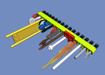

J_C Posted August 17, 2016 Posted August 17, 2016 Heaps of pure LEGO and zero damage options out there. I admit, some of them not suitable for all applications, but just for illustration 15 examples: Quote
Didumos69 Posted August 17, 2016 Author Posted August 17, 2016 (edited) Heaps of pure LEGO and zero damage options out there. I admit, some of them not suitable for all applications, but just for illustration 15 examples: These are of course useful too and I would also prefer using a pure LEGO option if sufficient. My option becomes useful if you don't want to have something sticking out of your pin or want to completely eliminate slack in the pin-pin-hole connection. I've read posts where people wanted to glue parts together or drove real screws in pins. In those cases I think this is a more elegant option. Edited August 17, 2016 by Didumos69 Quote
