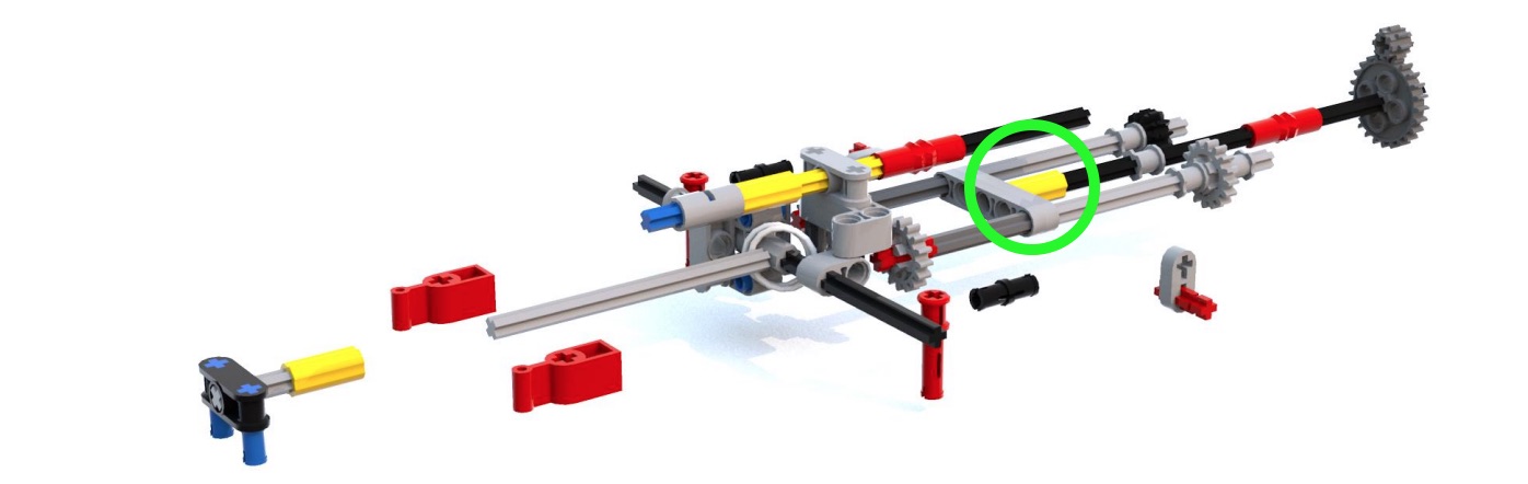

Didumos69 Posted October 15, 2016 Author Posted October 15, 2016 (edited) Thanks to some feedback I received from @t12ung I have been able to improve the errata. No real corrections, but two additions that should reduce the chances on misinterpretation: 1. The blue 3L pins inserted in step 74 of the original building instructions have mistakenly been forgotten in step 75 and further of the errata. Step 74 of the original building instructions should not be omitted. I made a note on this in the errata. 2. When the orange (+0)-liftarms are put into place in step 100 of the errata, it's important to make sure the one to the left side of the gearbox aligns with the (+0)-liftarm inside the 5x11 H-frame. I incorporated the importance of this in step 100 of the errata. The corrected PDF with errata is available via Rebrickable. Edited October 15, 2016 by Didumos69 Quote
