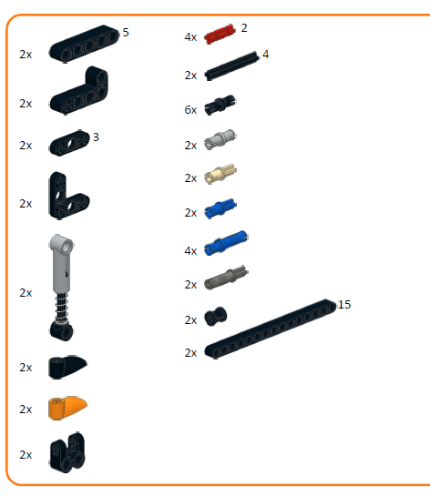

Sadly you did not include TWO changes I really want to include in my own model:
- a working door lock mechanism; either the spring loaded vEfferen or the simpler DayWalker method
- a body removal conversion (why on Earth did LEGO hide all the mechanical marvels under a fixed body anyways?!)
For vEfferen's idea I did find the attached parts list and plan, albeit without part NUMBERS/NAMES. I am lost in LEGO's maze of components and do not want to order the wrong ones. I am awaiting Allard's reply, but he does not seem to have these names/numbers at hand either so far. Who can identify the depicted elements below?
As to the body removal I assume that only a few different studs may be needed, but have not seen a parts list similar to the 'minimum' MOC list.
Any hint about how to include all these extra needed parts to a single order (hopefull from one German source) is highly appreciated!
