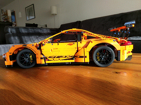

Talking about stickers: found additional stickers on the internet especially made and pre-cut for this model. See the pictures below of my finished build of Didumos69 ultimate playable version. This build is amazing !
I think the extra stickers really complete it :classic:
After nearly 30 years of not touching LEGO, I think this build really got me into it again. I am already considering ordering the missing part to build this MOC: https://rebrickable.com/mocs/crowkillers/scorpion-ck-r-supercar, although that means I have to disassemble the mighty Porsche. But hey: than I can re-assemble it again after I get tired of the mentioned MOC... :wink:
Given the level of detail of this model, I can imagine that applyinmg stickers - even the third-party ones - actually add something. I never apply stickers myself, but that's not important.
WOW! that definitely looked way better than the plain doors :) BTW would you happen to have the list of extra parts needed for the Scorpion MOC? thanks
