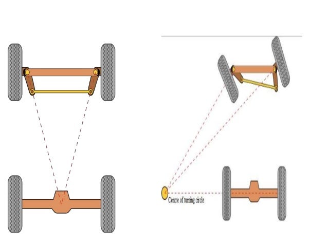

ludov Posted July 6, 2016 Posted July 6, 2016 Thanks for the diagram, but that was not the confusion My question is in this picture: why does the configuration on the left has the result on the right? Or, in other words, why is the lines intersecting in the center of the rear axle (left image) required to have Ackermann steering (right image)? I understand the trapezoid is an approximation of the perfect geometry that works for all angles, and probably I could figure out why if I wasn't too lazy to do the geometry In any case, I don't want to further distract your topic! Quote
