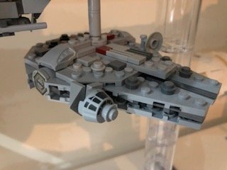

Some reinforcements joined the battle scene
The newest ones are GR-75 and my own creation a IGV-55 Gozanti class surveillance light cruiser (Star Wars Rebels)
Will pause this project for the meantime, as i have plenty of work outside. Looking forward to your new creation @mortesv!
