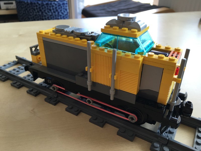

As detailed there i was trying to get some trains of ebay and basically got the yellow train alone, but was later able to get the sets 7939 and 7938. So now i had two yellow cargo trains :P Well i needed a shunter anyway, first i though to also get the loco from 3677, but wasnt able to get one on ebay for a decent price. Well with the 2nd yellow cargo train i thought why not try to rebuild this one. Thats basically how i found this forums, while hunting for ideas. Though my brick supply is limited so i mainly used stuff from the set.

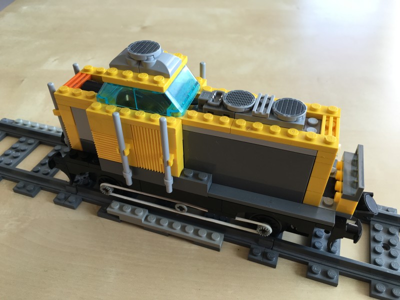

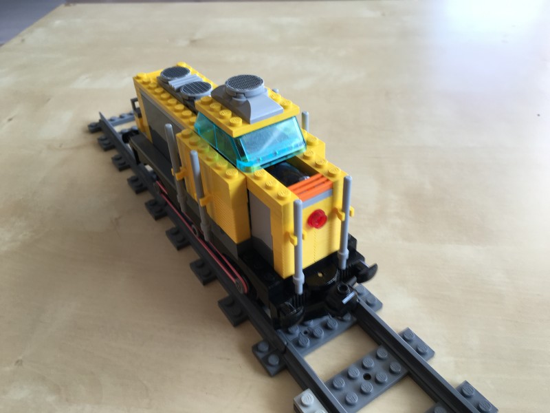

Anway: That is what i came up with, its rly basic and i tried to use most of the stuff from the 7939 loco.

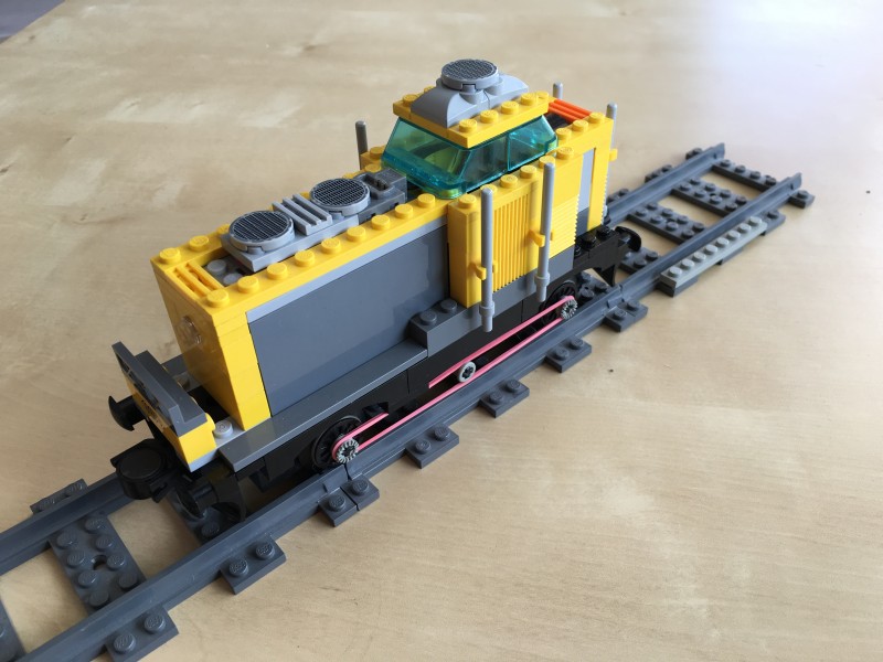

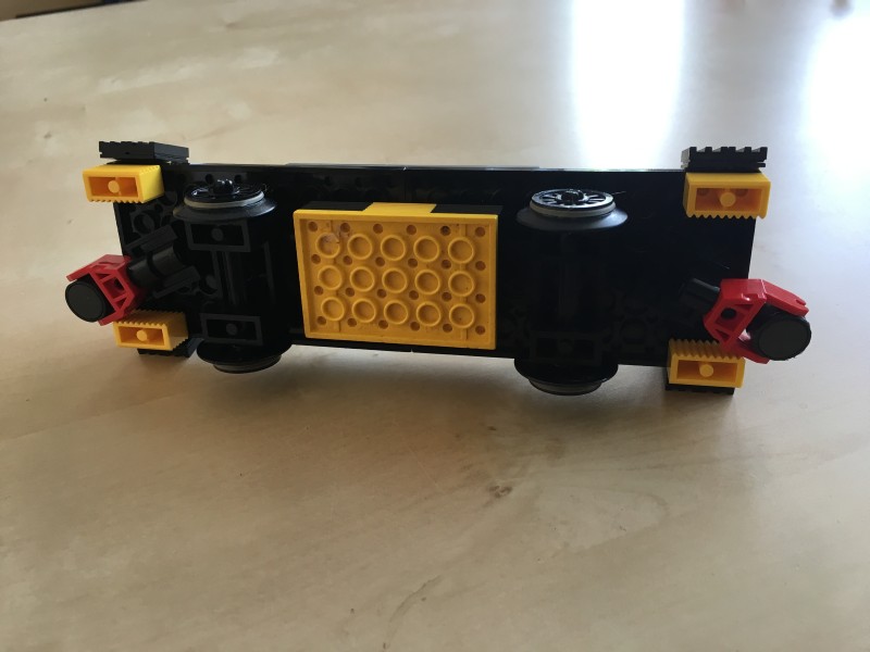

At first i tried a 3 axle design but it didnt went through the turns. so i removed the middle one. But with only 1 motorized axle i had traction problems with the longer wagons on the junctions and on turns. So i came up with the idea to connect the front axle to the back axle. It was way to far for gears, so i simply used two rubber bands and i must say it did work out really well, now the loco goes through all the joints without a problem.
I really need to get me two of these 6-wide windows, guess it will look a bit better, And also some kind of plate above the cabling so i can have a nice cab inside.

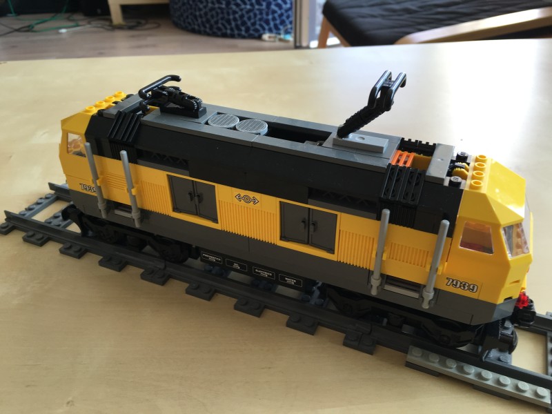

From the leftover parts i did put a 2nd pantograph on the yellow freight engine, i found it looked really weird with only one and didnt like the look.

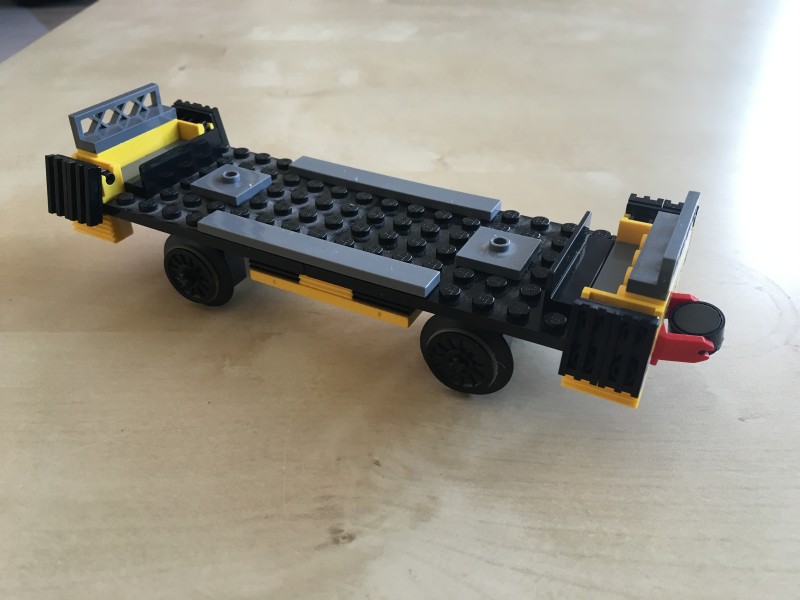

And from the leftover bricks and some of my own parts from the old days i used the 2 remaining axles to build a small flatbed.
It is really not much compared to most of the stuff on here, but maybe someone gets his ideas like i did from some other post about a small shunter on here.

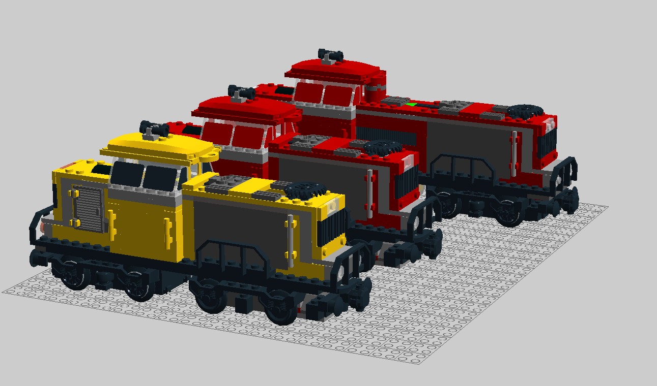

I was thinking baout getting the locomotive from the 3677 set. I read somewhere here someone shortened it, so today while bored i played around with LDD and build the locomotive from the instructions, then i fiddled around until i had it shortened quite nicely. When i looked at it i reralized i like both versions very much. Even might keep the grey on the battery box cause imo it fits well. Anyway i realzied i won't likely be able two get to locomotives from 3677 as they seem really high priced around here in germany. So i got the idea why not usethis MOC and try to rebuild it into a yellow version. Well looking at what i need to buy i might asell buy everything and keep both.
