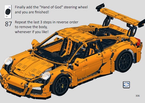

I published my MODs to pimp up my Porsche including 314 pages building instructions on Rebrickable.com.
Have fun to pimp up your Porsche, if you like!
@jb70:
very good Package you have compiled - something i have waited for a long time:
the full errata of Didumous enhanced with his mod of Additional shock absorber and improved ground clearance for front axle (Imho the retail Front axle is one of the most annoying pitfalls of the retail Porsche) and the Hispabrick mod for an easily removable Body..
Now even with HoG, great- this is the Porsche TLG should have released....
thanks a lot for the all inclusive PDF BI!!!
Edited by Kumbbl

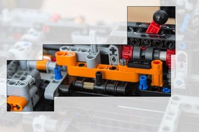

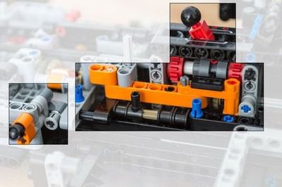

Hi Guy,
I have updated the mechanical system to avoid having 4 rear gears. It is the same principle, but simplier.
Here are few pictures of the system, completely hiden at the end behind the black pannels. Note that the 2 black elements 4173668 should be replace by a single black Technic Cross Block/Fork 2X2. Last, the front and rear speeds are reverse, in the same position as the real GT3RS (but on the sticker of the gear box, we should exchange the position of the D and R letters)

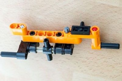

Well recently I started building this set. I got to page 110 before I couldn't take the sheer amount of obvious Technic flaws in this model anymore. Luckily there was the work of @Didumos69 and others that fixed pretty much all of these glaring issues within weeks after release. So I started to apply some mods. Then I remembered this model still didn't have a proper 1 speed reverse solution. I never really liked Max Supercars' mod, because it only stopped the problem, it didn't remove it, plus it wouldn't work with the HoG shift mod.
Then I remembered @Jeroen Ottens DB11 mechanism of 1 reverse gear which was stupid easy to apply to the Porsche as well and should work with most/all (?) previous mods for this set.
In order to preserve ground clearance I had to use 3x 8T gears here (these are only hooked up to the front 16T gear obviously), which meant I had to invert the output of the driveshaft from the gearbox (the 3x 12T bevel gears between the gearbox and the D-N-R switch visible in the next pic) so the engine still turns the same direction while going reverse. I didn't apply Didomus' "eliminate friction in the gearbox" mod, but this whole thing runs very smooth on my chassis.
The reverse axle then meets the centre of the gearbox at the bottom. This has the same gear ratio as first gear. Easy simple mod, courtesy of Jeroen Ottens, I couldn't have thought of it even if I tried :grin:
Another mod inspired by Jeroen Ottens' work on the DB11: an attempt at counter steering (gear 1+2) and crab steering (gear 3+4).
Instead of using an additional driving ring to give 4 more speeds like the DB11, I decided to try and add a switch for this function, combined with Didumos' work on the PDK shifter for the gear indicator mod I had a nice amount of space in front of the D-N-R switch to give this mod a whirl.
Due to the given play in Lego driving ring gears, there's a huge amount of slack in the rear axle, so much that the function won't work when the model is on the ground. I doubt it will even when I add some form of return-to-centre on the rear axle. All I know at the moment is that the hockey spring is too strong, but I didn't want to use that option anyway, because I wanted to use current parts up to 2016, basically the stuff that was available at the release of this set. What I also wanted to do was make this mod compatible with box 2, which I managed at the front with the switch mechanism, but failed at the rear with the steering rack, there was no other way with 2 springs blocking my path. Also about the rear with the gears and rack, that part is heavily in the "mock up" phase, so that won't stay like it is, don't worry :classic:
In first gear:
4th gear:
The rear steering angle is different from the front.

@DayWalker: May i ask you for some bigger pictures - maybe on bricksafe or somewhere else - because your solution looks really interesting too...
Edited by Kumbbl
Expand
Here are the photos
First picture
Second picture
Third picture
This solution is compatible with the gear indicator in the center of the car and removable body (see older posts)
EDIT : ... and it allows rear speed and neutral only when the previous one was the 1st gear
Edited by DayWalker
