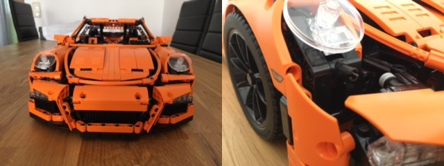

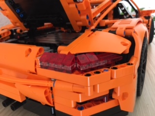

Finally finished my Porsche last Weekend. I've tried to fill the ugly gaps underneath the headlights. I also applied the taillight cover mod posted by efferman, but used only one liftarm on each side and additionally fixed them with a "+o" connector. Will update my post with a photo when i'm home this afternoon.
Edited by Danee
Finally finished my Porsche last Weekend. I've tried to fill the ugly gaps underneath the headlights. I also applied the taillight cover mod posted by efferman (http://www.eurobrick...25#entry2596596) but used only one liftarm on each side and additionally fixed them with a "+o" connector. Will update my post with a photo when i'm home this afternoon.
I can't find his tail light mod and your link brings me to beginning of the thread. Can you link the post?

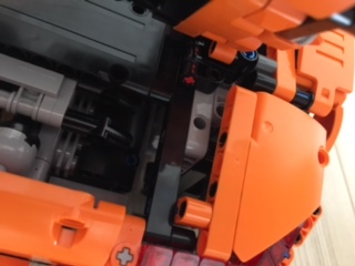

Sorry for the dead link, just deleted it, efferman posted it again, thanks. So here are two pics of the back. The Panel is still connected at the black 3x3 liftarm with a black pinhole connector as efferman did it in his lxf file. Just put it one stud nearer to the center.
