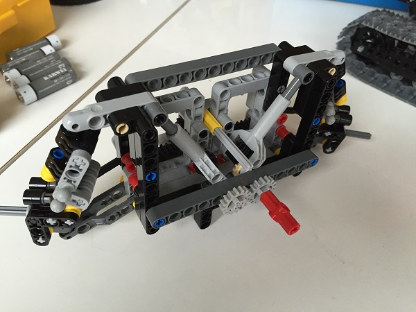

aefferen Posted June 12, 2016 Posted June 12, 2016 (edited) Here's my first mod to the front suspension, with positive caster angle, and macpherson strut suspension. I can't test it yet because I missed the first batches of sets. However based on the building instructions available via lego.com I expect this to fit. I also added the front lift of which I am pretty proud. However that one I need the set for to see how to operate it. The front suspension I added to another set I have to test and it works ok. This structure works best with the 9.5L shocks but that is too much for this model. It seems to be robust enough. However the 1/2 bushes better replace with Pin Connector Round 1L which I didn't have free anymore at the moment. As soon as I can lay may hands on a set I will go for another round of further improvements to make it more sturdy. Plus I will add the mods of others like the HOG and rear wheel steering. Some more pictures here http://www.moc-pages.com/moc.php/429712 Edited June 12, 2016 by aefferen Quote
Didumos69 Posted June 12, 2016 Posted June 12, 2016 (edited) Indeed interesting. As far as I can see you're not using the standard wheel hubs. How are you going to deal with the new rims not having axle holes? Apart from that, I like the concept. You could secure the perpendicular axle-pin connector holding the pivot ball-joint a little better by using a 4L axle with end-stop. In your second picture you can see it sliding off a little bit. Edited June 12, 2016 by Didumos69 Quote
