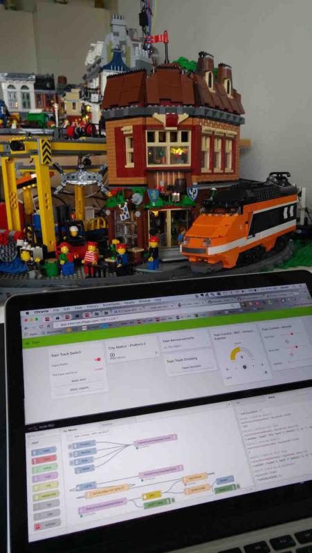

Hi Guys,
I just completed a big project to control my Horizon Express train with a NodeMCU (ESP8266). I also use a Raspberry Pi running Node-RED for the dashboard and IoT logic. I agree that the ESP8266 is awesome for IoT and LEGO projects, but it was annoying to program and build the supporting circuit, etc. I did it, but I felt like it was a time suck. I then stumbled on the NodeMCU, which is the lazy mans approach.. and that's me ;)
I bought the NodeMCU with motor shield on eBay for under $10. It works really well, but I think the motor shield was a little difficult to cram in the train. I was able to do it, but I would go for an external H-bridge motor driver, for flexibility.
The complete write-up is on my Internet of LEGO blog:
http://www.interneto...odemcu-esp8266/
Let me know what you think! I also am working on sensing the train location using reed switches. Since the train has magnetic couplers, the reed switch works perfectly for detecting the train.

Welcome to aboard. Awesome work. :classic:

How do you mount your servo motors to the track switches?
I switch the tracks with a 5v hobby servo and a single technic stud, attached by a thin piece of wire. These servos are not very powerful and the LEGO track switches require a bit of torque. I tried several methods while trying to keep it as minimal as possible. The final idea is documented in a previous project article. I also go through the Arduino/Raspberry Pi logic as well.
http://www.internetoflego.com/train-track-switch-servos-leds-pubnub-and-johnny-five-io/
