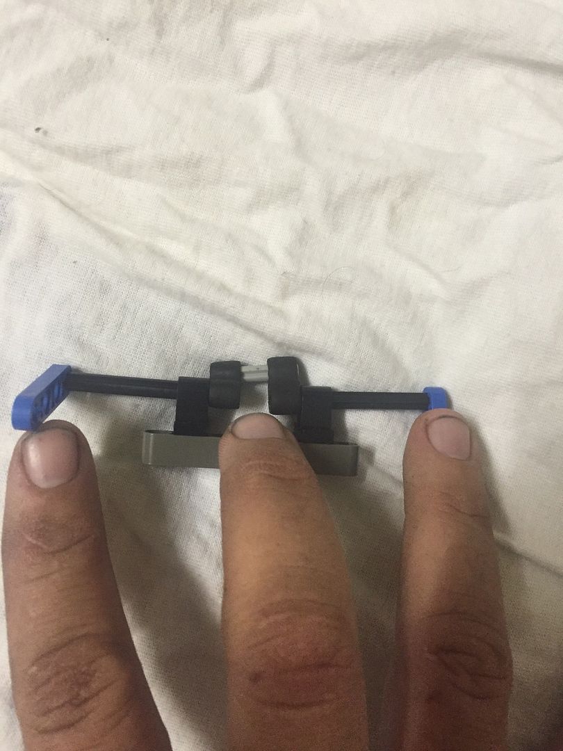

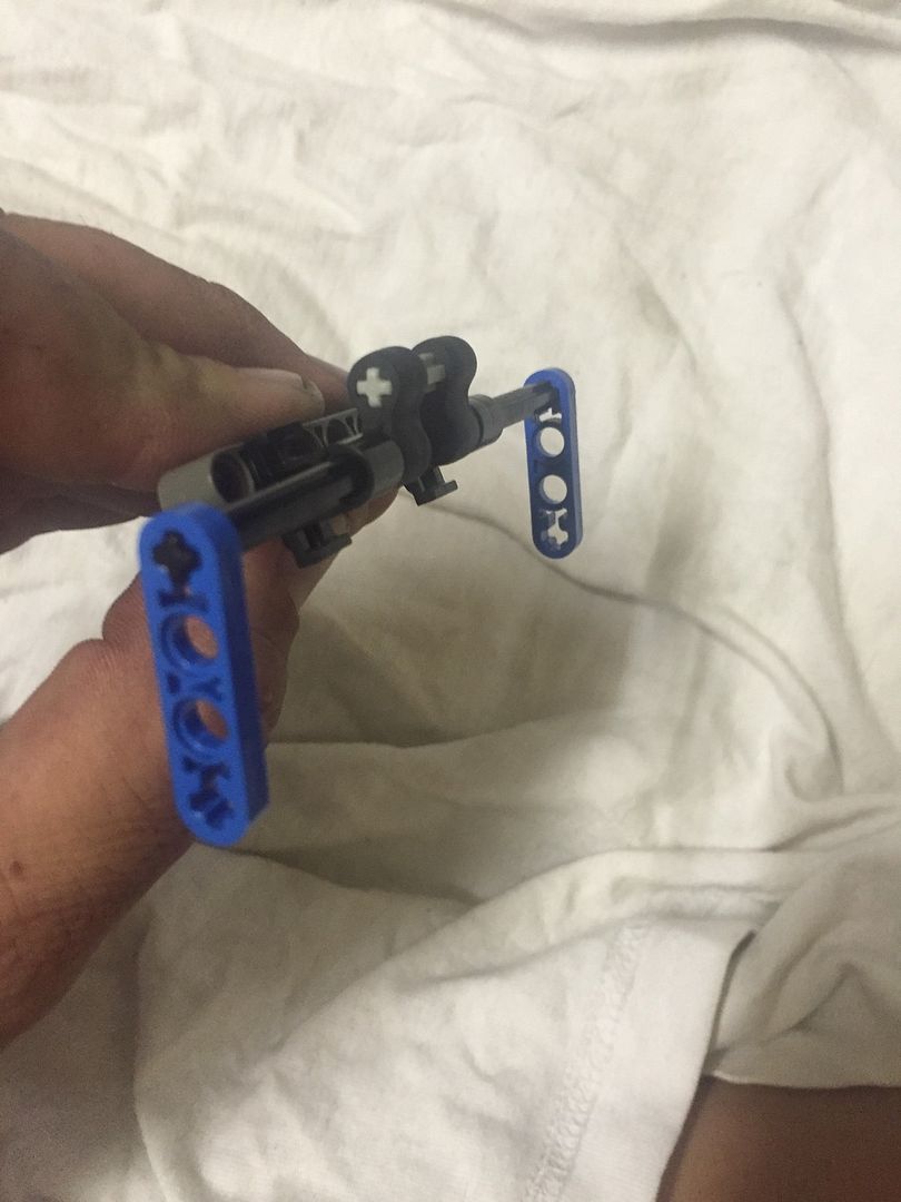

As i couldn't see a sensible way of making a lego axle behave reliably i used a rubber axle connector in twist to semi springload the liftback hinges on my 8880. It isn't a torsion bar as such as it's the anchor point (rubber cross slot) that does the "give" as opposed to the axle, but the principle is there.

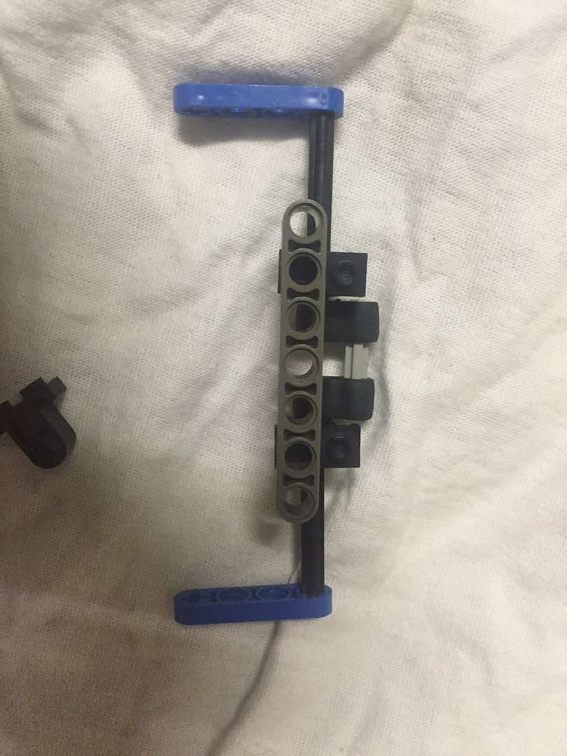

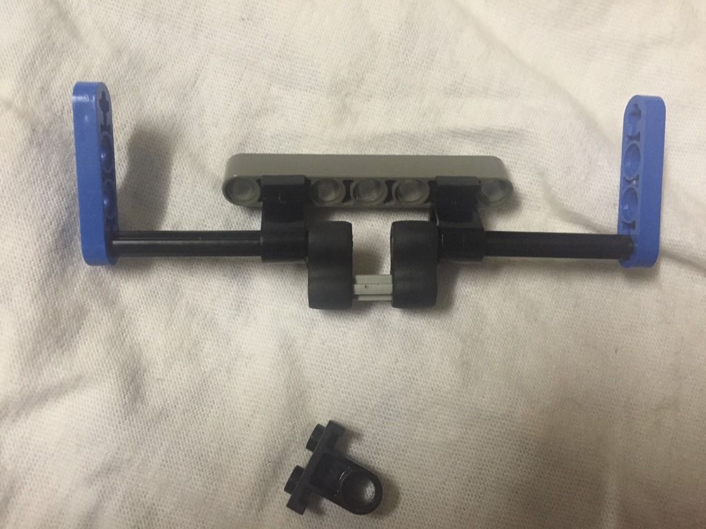

Could be adapted in principle with a pair of axles at paralell to each other feeding out of each side of a rubber bush with right angles each end feeding to the lower control arms but will in my opinion be fine, but why spoil the handling adding stiffness side to side vs except for 8865 what is generally either mushy or ridiculously heavy spring rates that make it behave like a wallowy yank-tank or the other extremity like a gokart.
I've built a quick simple example here i wouldn't bother trying to mount it on ant of my babies as though it adds a touch of realism will just upset the suspension compliance and playability.
This shows it in torsion as it would behave with one control arms spring in full rebound and the other in full compression.
Dr JB: never heard a sway bar described as a torsion bar as it isn't a torsion bar as such while it has to flex out of torsion when unloaded to go the other way rather than constant but varied tension in its operation. Shall we just agree you've got the incorrect term irrespective of whether its in common use or not?
Even the reinforced thing that i use here in the e30 mockup chasis is too soft for my taste. Your version with the rubber bits is unrealistic and will have no effect.

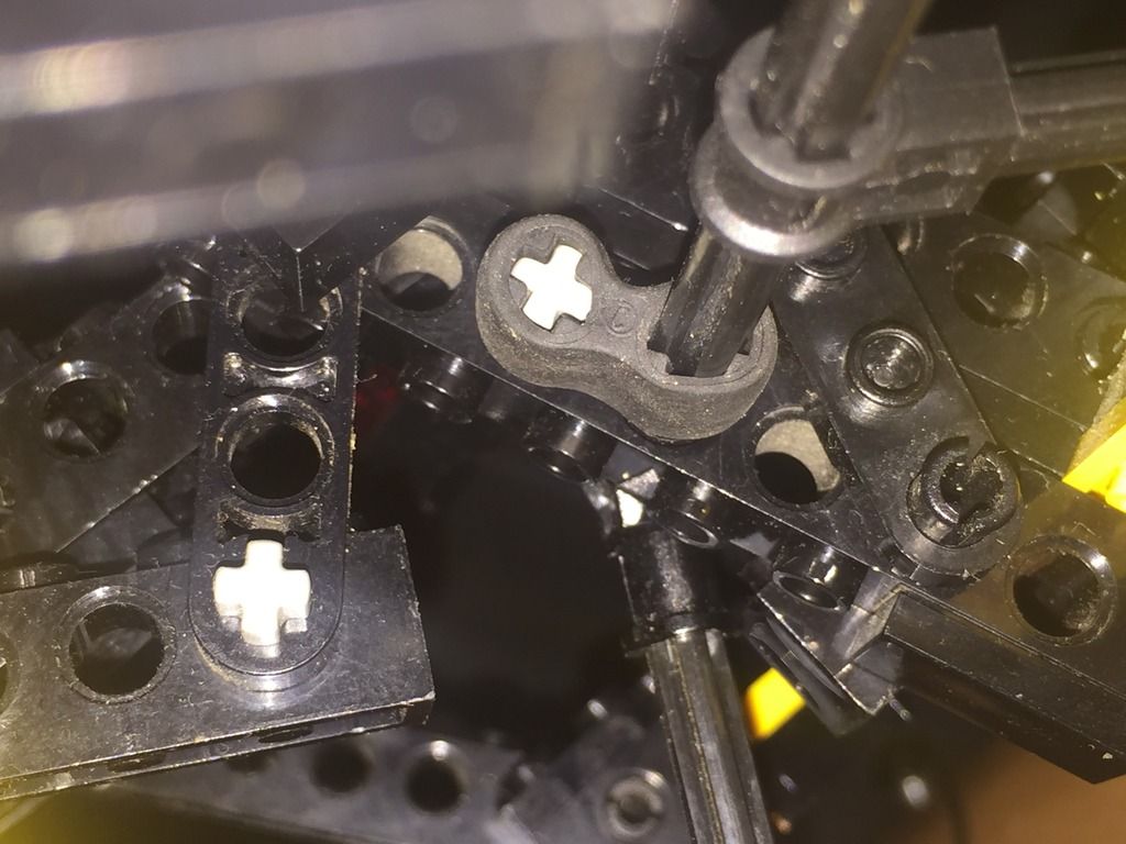

I once made the chassis for a 8880 sized blues mobile (dodge monaco). It used 12M axles as torsion bars for the front suspension. For the weight of just the chassis, engine and drive train it worked very well. Incredibly well in fact. But if I had completed the car the weight might have been too much I think. For prototyping purposes I held one end of the 12M axle fixed using a 24t gear mated to a worm gear which allowed me to adjust it while building. Worked great. Only about 5M of axle was free to twist.
