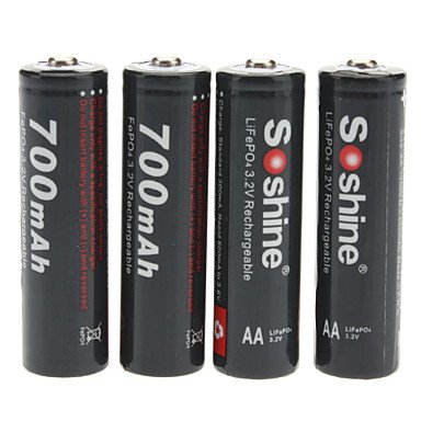

mikezang Posted December 12, 2015 Posted December 12, 2015 Maybe you heard there are some new rechargeable batteries as below: http://www.amazon.com/Soshine-LiFePO4-700mAh-Rechargeable-Batteries/dp/B00Z07RKWO/ref=sr_1_6?s=photo&ie=UTF8&qid=1449915598&sr=1-6&keywords=14500+3.2v+battery I want to use three such batteries with three dummy batteries in 9.6v for RCX or any PF devices, does this have any problems? Quote

Victor Imaginator Posted December 12, 2015 Posted December 12, 2015 9.6V should be fine, less than 10% more normal batteries. Quote
TheNextLegoDesinger Posted December 12, 2015 Posted December 12, 2015 this may be a to strong current: Normall alkali batteries are 1.5, so a batterybox with alkali batteries would be 9V With these it would be 9.6V, only way to know this is to test it Quote

Philo Posted December 12, 2015 Posted December 12, 2015 I don't think there could be any problem with these batteries. Found this test of a similar product http://www.candlepowerforums.com/vb/showthread.php?380867-Test-Review-of-Coolook-14500-LiFePO4-700mAh-%28Black%29 Discharge curves show that even at startup time voltage is not much above 3.2V. Hight current handling is impressive (though mostly useless with LEGO current-limited battery boxes), but capacity is not outstanding,.. Quote
