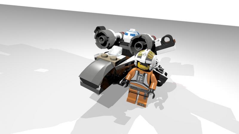

I worked with LDCad for maybe 2 hours now, and it feels much better to me then LDD did...
This is my first result in ldcad...
Edited by JoergH
Thanks a lot!
That is a nice one render for a beginner :thumbup:
