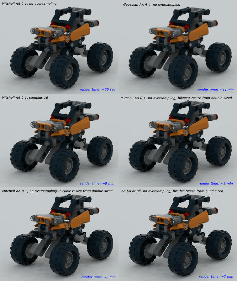

Victor Imaginator Posted July 22, 2015 Posted July 22, 2015 I make some tests and can conclude now: SunFlow oversampling ("sample XX" parameter) does work, but effect is barely noticed. Rendering time inceased by XX times. SunFlow antialiasing does work, and effect is nice, but far from ideal. Result is blurry and rendering time increased too much. Rendering picture oversized and using photoshop to resize looks much better than any SunFlow methods. Notice thin black rings around wheel axles at last picture. It's a geometry, and manual 16x oversampling show it, while SunFlow doesn't. Quote
