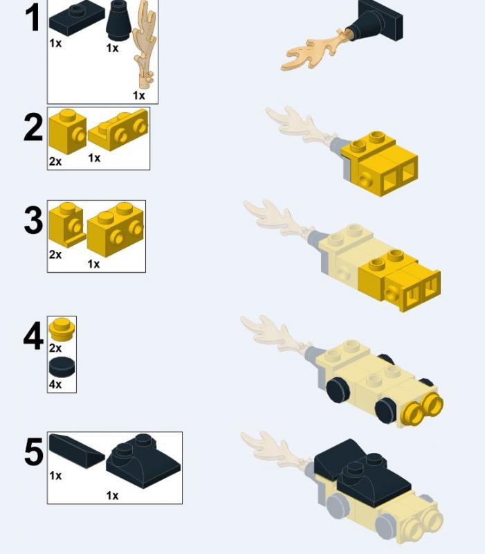

Just an idea for a better visual cue, maybe you can add these:
1. a parameter to adjust the outline thickness (normal and bold maybe?)
2. an option to change the 'new part' pink high light to be another color or maybe you can make the "previously assembled part" to become semi transparent and the new part to be solid?
This is especially helpful when making instruction with a lot of pink bricks to work with.
The idea of "semi transparent previous assebmly" seems great at first and i even implemented it some time ago. The problem is that "semi transparent" with a white background equals "lighter", so the problem is that black looks like dark gray, dark gray looks like light gray, light gray looks like white. If you have some of those colors together, it gets impossible to tell what is new and which color it is (insert fifty shades of gray pun here). Ditto for other colors.
I can make the pink parameterizable, anyway.

As for the semitrans suggestion: just make it semitrans with somewhat diffuse/constant material mixture = no shading and then unless a person is semiblind or posses at least IQ50 ( :laugh: ) one should be able understand what is what I guess. :wink:
And as for the "parametrizable" pink: you definitely should... :laugh:
Parameterizable pink will be great to have :classic: .
And if it's not too much to ask, an extra 'opacity parameter' option can be handy too. That way anyone can adjust color and opacity any way they see fit with their build.
