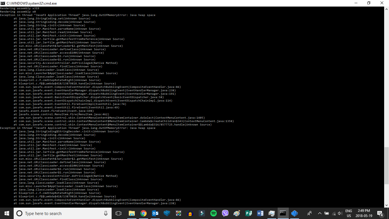

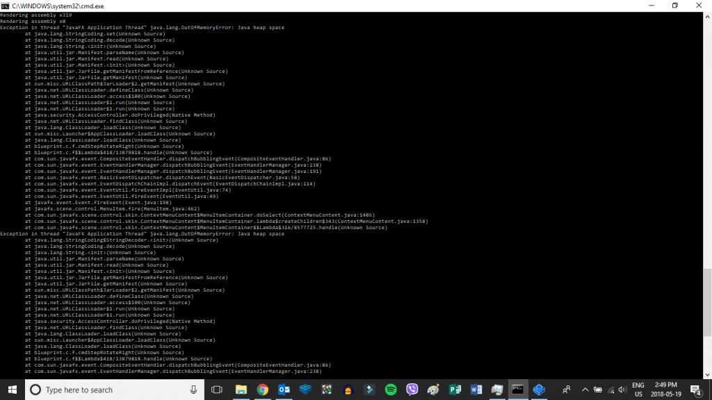

Brickstogo Posted May 19, 2018 Posted May 19, 2018 I'm loving this program so far, except I have run into a problem with my model. I'm 95% done configuring my steps, but my file will no longer save. Every time I load my design I end up with this text in my CMD prompt. I have no idea what this means, but it's causing me to be unable to save my work. It's quite a large build with a lot of steps, is there some sort of file size limit to the program? Any help would be greatly appreciated! Thanks! Quote
iceleftd Posted May 19, 2018 Posted May 19, 2018 44 minutes ago, Brickstogo said: I'm loving this program so far, except I have run into a problem with my model. I'm 95% done configuring my steps, but my file will no longer save. Every time I load my design I end up with this text in my CMD prompt. I have no idea what this means, but it's causing me to be unable to save my work. It's quite a large build with a lot of steps, is there some sort of file size limit to the program? Any help would be greatly appreciated! Thanks! By default, Java limits the amount of memory it uses fairly severely. The file you use to run Blueprint (blueprint.bat) probably has a line that looks like this: java -Djava.library.path=native -jar bin\blueprint.jar You need to add an option that raises the maximum amount of memory Java will use - something like this: java -Xmx2048m -Djava.library.path=native -jar bin\blueprint.jar That tells Java to use up to 2048 megabytes (2 gigabytes) of memory. You probably have plenty of real memory, a 64-bit processor, and the 64-bit version of Java. If you have a 64-bit CPU and aren't running the 64-bit version of Java, you should be. If for some reason the value of 2048 still doesn't work for you, you can try lower values until it does. Quote
Brickstogo Posted May 20, 2018 Posted May 20, 2018 50 minutes ago, iceleftd said: By default, Java limits the amount of memory it uses fairly severely. The file you use to run Blueprint (blueprint.bat) probably has a line that looks like this: java -Djava.library.path=native -jar bin\blueprint.jar You need to add an option that raises the maximum amount of memory Java will use - something like this: java -Xmx2048m -Djava.library.path=native -jar bin\blueprint.jar That tells Java to use up to 2048 megabytes (2 gigabytes) of memory. You probably have plenty of real memory, a 64-bit processor, and the 64-bit version of Java. If you have a 64-bit CPU and aren't running the 64-bit version of Java, you should be. If for some reason the value of 2048 still doesn't work for you, you can try lower values until it does. Thank you very much for your quick reply! I have been trying to figure out how to change this but I'm not great with this type of computer stuff, so bare with me please! The code that I have reads as follows: @ECHO OFF java -cp "bin/blueprint.jar" -Djava.library.path=native blueprint.Blueprint pause How would I alter this properly to make those changes? I tried changing the parameters within java directly but this didn't seem to solve the issue either. Thanks again! Quote
Brickstogo Posted May 21, 2018 Posted May 21, 2018 On 5/19/2018 at 8:03 PM, Brickstogo said: Thank you very much for your quick reply! I have been trying to figure out how to change this but I'm not great with this type of computer stuff, so bare with me please! The code that I have reads as follows: @ECHO OFF java -cp "bin/blueprint.jar" -Djava.library.path=native blueprint.Blueprint pause How would I alter this properly to make those changes? I tried changing the parameters within java directly but this didn't seem to solve the issue either. Thanks again! Solved the issue. For anyone else having the same problem here is exactly what I did to solve it. I created a shortcut of my Blueprint batch file, then right clicked to edit. Then I changed this text: @ECHO OFF java -cp "bin/blueprint.jar" -Djava.library.path=native blueprint.Blueprint pause By adding "-Xmx1024m" after the java text it worked! @ECHO OFF java -Xmx1024m -cp "bin/blueprint.jar" -Djava.library.path=native blueprint.Blueprint pause I started with -Xmx2048m but that didn't work, so I lowered it to 1024 and it worked fine. I hope this will help anyone with this problem in the future! Quote

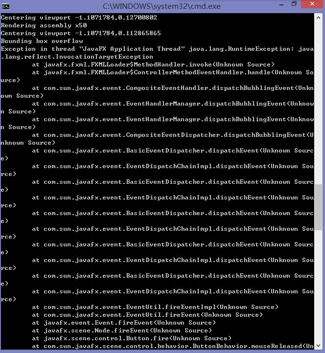

mfeldt Posted July 2, 2018 Posted July 2, 2018 On 2/23/2018 at 8:08 AM, mfeldt said: Crash when using part 76302 OUTERCABLE 80MM [...] New version! Yuhu! (1x1564.2) Caching brick aliases.. OpenGL version: 3.2.0 NVIDIA 340.104 OpenGL vendor: NVIDIA Corporation OpenGL renderer: GeForce 605/PCIe/SSE2 OpenGL shading lang: 1.50 NVIDIA via Cg compiler Loading brick 76302 OUTERCABLE 80MM Flexing element 76302 OUTERCABLE 80MM Exception in thread "JavaFX Application Thread" java.lang.RuntimeException: java.lang.reflect.InvocationTargetException at javafx.fxml.FXMLLoader$MethodHandler.invoke(FXMLLoader.java:1774) [...many more error lines...] Caused by: java.lang.RuntimeException: java.lang.NullPointerException at blueprint.b.b.a.a.b.b(Unknown Source) at blueprint.b.b.a.a.b.a(Unknown Source) at java.util.HashMap.computeIfAbsent(HashMap.java:1127) at blueprint.b.b.a.a.b.a(Unknown Source) at blueprint.b.b.a.a.a(Unknown Source) at blueprint.b.b.a.d(Unknown Source) at blueprint.b.b.a.b(Unknown Source) at blueprint.b.b.a.a(Unknown Source) ... 48 more Caused by: java.lang.NullPointerException ... 56 more Closing db. That's really a pity, because to my taste, blueprint is the only tool which enables the efficient production of instructions that can really be used! I just wanted to follow up and note that this was solved by making Blueprint use an updated version of the db.lif. Now I have another question: Blueprint can highlight the current parts added in a particular step. Is there any way so influence the color used to highlight? I don't particularly fancy the pink.... Quote
