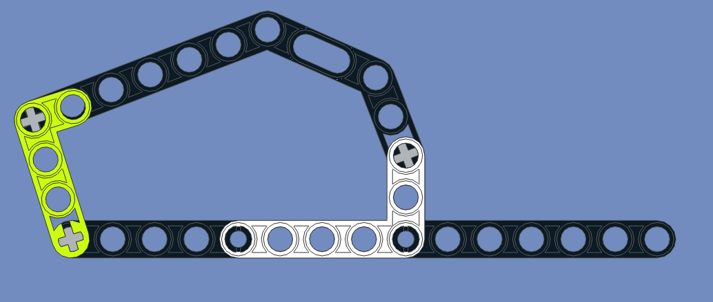

I have been seeing this type of problem fairly often now that I've been building more technic sets. When using angles, parts don't line up the way they should. Has anyone else experienced this? Is this a LDraw problem or Bricksmith? I haven't had a chance to test this with windows software. See pictures from 42021 (Snowmobile) below.
and the official instructions
any thoughts? File Download (this is a partial of the model)
I can confirm that: There is no way to make it match perfectly by using Sr3D or MLcad.
But there is no need to worry about it: It is just the same offset as in real life. Right now I made a quick check. It's clear: In real life it is no problem to pull it a tiny bit to make it match.
Thanks for checking, I thought it would probably be something like this. Real bother is that it will affect the rest of the build as the offset will get larger and larger. But I'll figure it out.
It wont fit when you have two pins/axles in the left hook beam, but this model uses one pin which allows for additional movement.
In such a case it will be possible to get it exactly right
You could use my LDCad's selection info feature for it.
Thanks, but if you look at the instructions, you'll see the section with the "headlights" needs to be aligned as well which is impossible if I would angle it as you describe. It's probably a combination of flexing parts and your solution.
