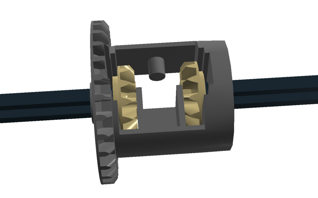

sadly I have run into an issue after the first stage, where I am trying to install the differential inside the square brick and couldn't but eventually figured this out, however I the discovered I could not get the program to allow me to put all three conical whel gears into the dif. I will attempt to insert a picture to illustrate this.
is this something that I am doing wrong or is it a bug issue? any assistance and advice to me would be very much appreciated

I have just discovered that you are required to rotate the gears to make them mesh so have resolved this issue but advice is still very welcome

The conical wheel is 12 teeth. So just place the middle one first. and hinge(rotate) it 15 degree (360 / 12*2 = 15). Then you can place 2nd and 3rd wheels.
