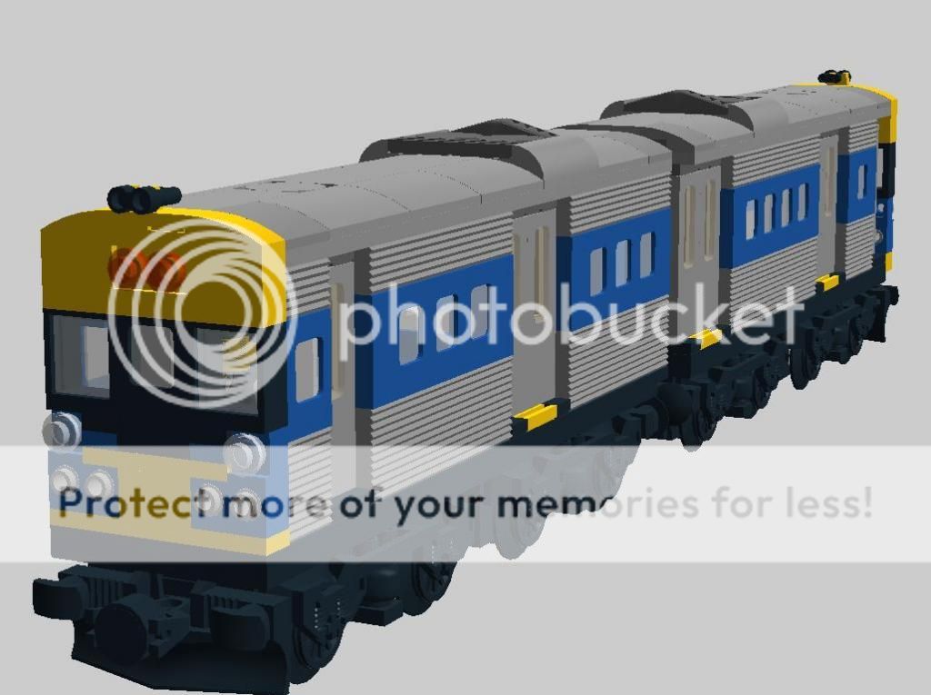

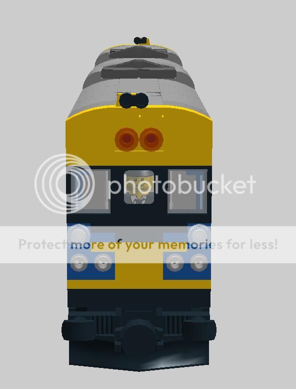

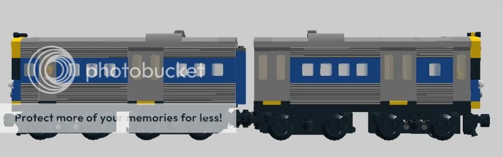

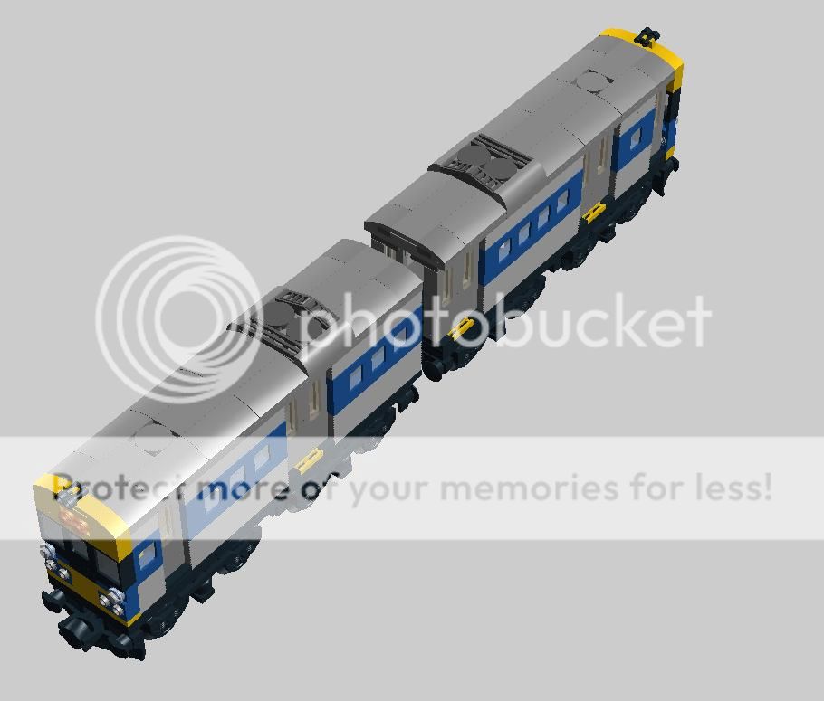

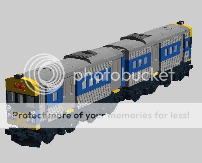

stu808 Posted February 10, 2015 Posted February 10, 2015 http://en.wikipedia....l_multiple_unit Right this is my first posting of MOC that is yet to be parted up and ordered. Also this is my first attempt at a commuter train. Looking for comments, suggestions, praise, criticisms, money, etc... A few basic specs about the design- 6-Wide to fit on my layout Modeled and scaled for 'Minifig' scale to fit in with my other trains Modeled in the 'MAXX Blue' Colour scheme, the colours they got retired in Only two train bases long as I feel this is what a Lego commuter train would be. If a inter-city passenger train is three bases long and a cargo train is four long, then a “commuter” would be smaller again. Tried to fit it on one train base, but looked wrong. Still not overly happy with the underside of the train... may change, or may not if some uppity security guard at Britomart grabs me for attempting to peer under the platform. Stu :) Quote

jtlan Posted February 11, 2015 Posted February 11, 2015 It looks a bit too small; I get that you're trying to have it fit with your layout, but it looks odd on those bogies. I'd say try lengthening it by one bogie-length (10 studs) between the bogies. If you're not opposed to it, and there's no extremely narrow tunnels on your line, you might try widening it to 7-wide ... it'll look a bit better proportioned, and you should be able to fit more seats inside. Last thing: I'd enable the "Outlines on bricks" option in LDD, which will make the render look a bit more like the real thing since it shows the separation between parts. It'll also make it easier for people to advise since it's easier to see how the model is put together. Quote
Steinkopf Posted February 11, 2015 Posted February 11, 2015 I like the work you have done so far, I would suggest however that you stretch them out a bit more to between 32 to 36 studs in length, that way you will get a bit more space between the bogies where you can add some details to the underframe. With the train base you are probably best off making a plate built version as it gives you a bit more flexibility to where you can fix the bogies as well as how long you want it, the 28 x 6 train bases are great if you are going 32 studs long as you just have to ad a 2 x 6 plate each end to lengthen it, mind you they are far from cheap in black these days. Quote

zephyr1934 Posted February 13, 2015 Posted February 13, 2015 The colors and flow of this build are nice. But I don't understand the right hand unit in the photos, there is a door on what one would think should be the end of the car... or are the left and right hand cars actually the top of what should be a single car? If they are supposed to be a single car, that might be too much of a stretch. Though with only the smallest amount of work it could be a really neat foreshortened pair of cars (kind of like the stumpy Star Wars sets with a single minifig). Quote
