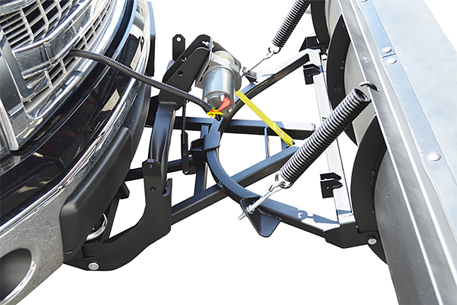

Plow is elevated by winch. This scheme is popular in cheap and simple snow plows. Tilt in such model usually manually customized or use hydraulics. I used lever-push mechanism to tilt left/right. Plow can be dropped easily and you can use winch as regular.

Simple snow plows (usually hand-made) are liftable by standard winch, and left righ tilt is manual contolled with links and several attachment holes for them...but I can use two M motors, so I can build advanced...
Advanced plows include hydraulics. So I can do advanced version with 2 small actuators/ worm gears for up/down and left/right. Winch version is more versatile, since you can use winch as winch without installed plow.
any ideas?

Plow with "rubber band" absorbers. Lifting with winch.
Left/right tilt is not developed yet:)
