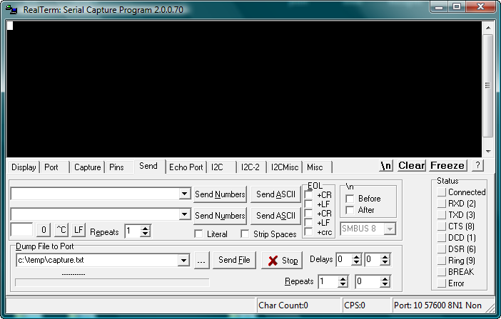

I've found Realterm. I thought, that if I put here some commands like "0x00 0x3B 0x08", NXC make some noise. If I put here another code, NXC would read it's inputs and sends it back. Without uploading any program to NXC or at my notebook. It's not really how it works?
Attached File  2012-11-22_204458.png   39.54K   26 downloads

The solution for you depeneds on level you would like to work on.
On the lowest level, BT communication is a sequence of bytes written to a BT port and reading response. That is what you see as those 0x00 0x03 ... examples.
But nobody want's to program like that. So task for the library writer is to give some nice names to these sequences and pack them into functions. From that you see commands like readSensor, runProgram etc.
Select on which level you actually want to work and we can try to help you. DLuders showed you the best link directly from LEGO website. In appendix 1 of the BT SDK you will find the codes and byte sequences for the low level operations. In apendix 2 you can find byte sequences for basic operations like playing tones or reading sensors.
If you have this a some school task without any experience in this communication area, it will be difficult. You will have to learn not only communications basic but also the protocol used by the NXT.

Serial communication usually begins with a start bit to indicate the start of the message/command, followed by the data bits/bytes and it end with a stop bit.
http://www.wcscnet.c...lComm/Page1.htm
Include an image like this:
Posted Image
Or this:
Posted Image
Add some example commands, like the "play sound" command. Describe the databytes for the various commands, which can be sniffed with RealTerm.
That will probably suffice!
