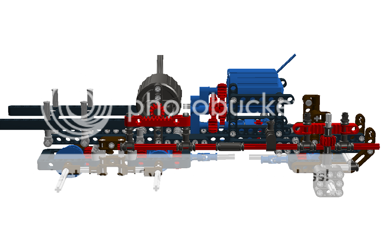

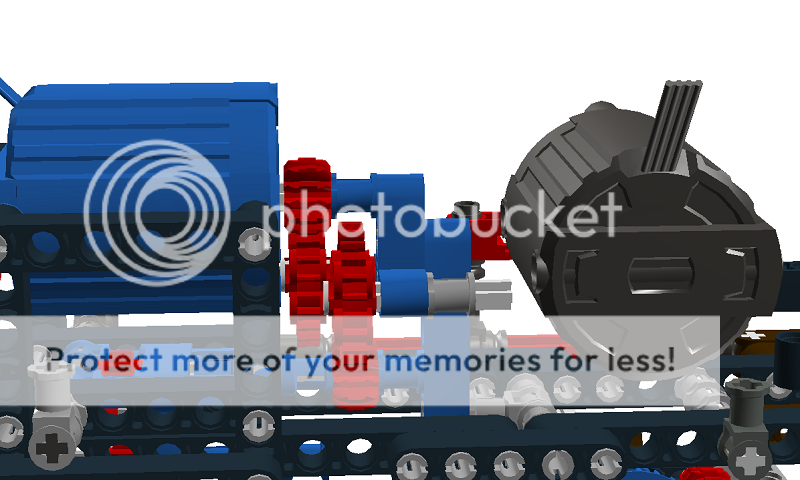

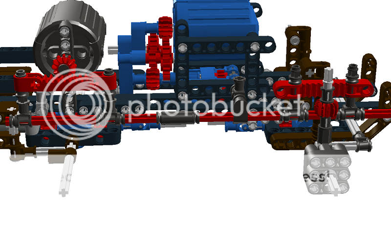

I have been working on a project myself. A 6x6.
All I have are the axles and the motor connected with shafts because im still not sure how to create the suspension.
Tell me what you think. :)
Here it is:
Version 1: Suspension
Posted Image
Posted Image
Version 2: Suspension
Posted Image
Posted Image

I would guess that with version one you are making solid axles pivoting around the driveshafts, whereas version two would use independant suspension at each wheel.
By using solid axles you will be able to get more wheel travel than with independant suspension due to the limits of lego suspension parts. There are quite a few model designs on the forum at present so have a browse of those designs and maybe look at more on brickshelf.com for more ideas.
Edited by Bricktrain, 28 September 2012 - 11:23 AM.

First thing that comes to my mind is, only 1x M PF motor to drive 3 axles?  I would use at least 1x XF PF motor (I personally like 1 per axle, but that's probably overkill).
Edited by dandexter, 28 September 2012 - 12:31 PM.

I think you will put too much stress on the universal jonts.It would be better if your used gears instead.I also think you will need to use a xl motor for drive.
Edited by Alasdair Ryan, 28 September 2012 - 01:28 PM.
