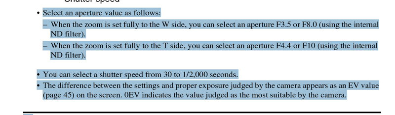

Great, so what does any of this mean? :blush:
Attached File  Screen-Shot-2012-09-01-at-8.24.jpg   67.04K   0 downloads

I'm not sure how much you already know, so I'll just start at the beginning. :wink:
The aperture is the size of the opening for your lens. It's also referred to as "f-stop" and "f/stop", I have not ready your whole manual myself, but a lot of camera manuals will use all those terms interchangeably.  The larger the number, the smaller the opening. :wacko: that's because the number is actually the bottom of a fraction, so if you think of it as 1/X it's easier to relate to (at least for me). The fraction is, in simple terms, the size of the opening in relation to the size of the lens. I'm already getting too technical here, but just thought I'd give you a little background info.
The point is that when you are NOT zoomed in, you can set your "f-stop" between 3.5 and 8.  F3.5 is what would be considered "wide open" for your lens. That means it is letting in the most light possible through the lens to hit the sensor. An open aperture like that will create shallow depth of field in your image, which will then be compounded if you zoom in (your camera will automatically close the lens a little bit as you zoom in, this is a physical limitation of your camera).
This is the only setting that will affect your Depth of Field, so I recommend concentrating on learning how aperture works and how to manipulate it on your camera. Looking at page 31 it looks pretty simple to adjust your settings using the < and > buttons, but if you have difficulty I will see what I can do to help (I can't buy a copy of your camera though :wink: )
Things to remember:
  • Aperture = F/Stop
  • Smaller number = bigger hole = more light = shallow DoF
  • Larger number = smaller hole = less light = deep DoF
A little trick you can try to help you understand how the aperture works, at least it helped me, is take a sheet of paper and use a paperclip or pin to poke a tiny whole in it.  Look through that hole at an object across the room.  You'll notice everything is in focus. Now take another sheet of paper and cut a dime-size hole into it. Look through that hole from the same position, at the same object across the room and you should be able to notice that the area around the object is not in as sharp focus as the object itself.  This doesn't work as well for everyone, but you might give it a try and see if it helps you understand at least the idea behind the way aperture works.
