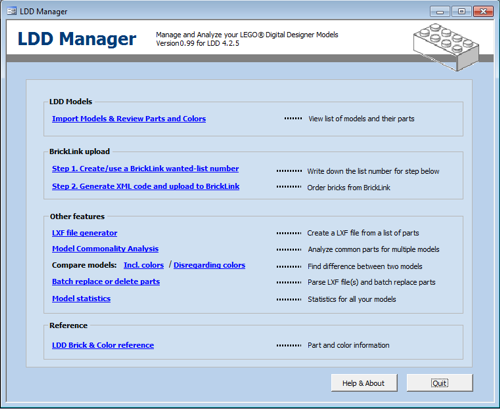

Hello everyone
OK, after some intensive work mapping the new bricks in 4.2.5 to BrickLink counterparts, here is LDD Manager 0.99!
Posted Image
New features in this release:
- Full support for 4.2.5
Or rather for the bricks that existed in BrickLink as per today, January 20th. For example there was a few Collectible Minifigs series 6 utils that weren't yet parted out at BL, and those are therefore not included. But otherwise it's all there.
- Color substitution analysis.
This is kind of a cool feature. If you've ever had a MOC or official set, and wondered if any of the colors can be changed to something else, this is for you. A typical scenario would be that you've made a MOC with some nice trimming in some color. Now you wonder, can ALL those parts be replaced by an other color, for example Red or Lime. Or if you have a set, like the 3177, and wonder which other colors that can be built in.
- Similar part info
If you've used a part in LDD that gives you a warning "Color does not exist", then this feature will search the database if there is any similar LDD part that exist in that color, and you'll be notified. Basically what this does it bridge over similar parts in LDD, for example 60212 and 3788. It will also give you a warning if you do the classic mistake of using the 3066 1x4 Brick without pins instead of the 3010 with pins.
- More advanced batch LXF replace
I added the possibility to use color as criteria when batch replacing or deleting bricks from an LXF-file. It's not a feature you would probably use very often, but if you need it, it will save a lot of time.
- Updated Brick and Color reference info
LDD Manager has a very accurate and up to date BrickLink to LDD color mapping. It also has the only search function that I know of that allows you to find bricks based on their attributes (i.e "which bricks have a 3.2 mm bar AND a Technic Hole).
I'd like to take the opportunity to say a big thanks to Aanchir who helped me to map all the new decorations to BL counterparts, and to Bojan for some other help.  :classic:
Download LDD Manager here. And be sure to check for updates now and then.
And as usuall - if you find any bugs or miss some feature - let me know.
