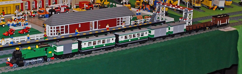

I agree with this approach - get the loco as good as possible without worrying about how to power it. Here's my green train at STEAM last weekend: Brick Express Large Prairie loco, pusher wagon, two coaches, two box cars, two open wagons and a guards van. I used an old 16-stud train base with motor cutout for the pusher wagon and it only needs four inverted slopes and two plates to attach the motor.
Jonathan
