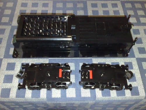

The two motors have to be mounted facing in different directions underneath the tender, because the buffer beams sit on the opposite side of the connecting points on the motors (if you understand what I mean), like this:
This means that if I connect both motors to the same connecting point on the IR receiver, they pull in separate directions, which needless to say is not very practical. The alternative is to connect one motor to each of the IR receiver's two connecting points, but then I have to control both motors separately, which is also highly impractical.
So, the next question must be: Is it possible to get one of the motors to spin in the other direction?

You can use the reversing switch, as mentioned or pick up a couple of short 9V cables from the 'bay or Bricklink. You attach one to each motor but connect the other ends in the opposite direction to each other i.e. a cable sticking out each end. Then connect one of your extension cables from the IR controller to the stacked connectors. An old solution to a common problem.
The problem you might also find with using the PF connectors straight onto the 8866 motors is that they're slightly too thick for the bogies to turn easily when used with standard train baseplates. The 9V cable connectors are slightly thinner so avoid the problem.

I've just placed an order for a reversing switch - I'm going with that option because I can get it relatively cheap without having to go for used pieces, and I can still use all the pieces that I've already got. As the tender is eight wide it's not built on a regular train base, so it's no problem that the connectors make the motors a tiny bit taller.
You don't need anything else to get this to work.
If I am correct, you should simply change the position of one of the two small black switches on the controller.

You're not correct. Both motors are connected to the same channel so using the switches will alter both of them.
Ah yes, then you would need an extra receiver... :laugh:
...which is quite a lot more expensive than the reversing switch!

Snipping the wires on one of the power cords and reversing them would likely work as well. Cheap little modification if you like dinking around with that kinda stuff.

The reversing switch is a life saver. Unfortunately on several of my builds I've have had such little room left over that installing the switch caused it to switch into the opposite position. :)

You have to be careful there - the PF system uses four wires, and you have to be sure that you're swapping the correct ones. Two of the wires are direct power, and two of the wires are signaled power. I'm no expert, but I think the motors receive power from two of the wires when powered directly from a battery box, and the other two wires when getting power directly from the IR receiver.
Hi Tony and L@GO,
that is right and real quick: The 2 "outer" cables are +9V and 0V or ground. The inner two are called C1 and C2. All "dumb" devices like motors and lights get power from C1/C2. All devices requiring permanent power (e.g., receivers) do get that via 9V/0V and "forward" power via C1/C2 to motors/lights, mostly PWM modulated. You may want to look up Philo's PF reference page.
So when you want to reverse the motor direction you need to "cross" the inner two (C1/C2) wires.
