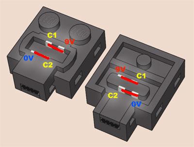

I'd bought a couple of these via the Bricklink store. Although I would have no issues to make these myself, it was more a cost vs time decision (I had no time). The end result is pretty good, although the tight junction to the 9V battery means you often fear ripping the plug off.
Because the two lines C1 and C2 are not connected, the power supply wont switch on a PF light. First the connector must be fed through a PF IR receiver in order to generate the correct control lines.
A 9V battery is too wide to fit into a 2stud gap; it ideally needs 3 studs to lay lengthwise. I modified some 4512 locomotives to do this; and it works well. In the tests I did (somewhere on this forum) the 9V lasted for about 1.8 hours continuous use pulling a set of 4-5 12V carts.
But there is no problem connecting them too... this way a PF light or a motor could be run directly off battery (preferably with a polarity switch inserted to avoid need of disconnecting the battery or the device)

It's VERY easy ... you need the following (all are standard Lego items):
- old 9V battery box
- adapter cable (from 9V to PF connectors)
Now, with above setting, you can power any PF motor (or light) directly (you can also ise a switch/polarity inverter).
If you want to use a remote receiver in between, there is one additional detail: The 9V powering the motors/lamps are fed through the inner two wires of the PF connector. The outer 2 wires are for powering the PF remote receiver. To energize the receiver, you need to provide power to the outer wires. This can be easily done by connecting wires 1/3 together, and wires 2/4 together. To do this, you need to inseert small pieces of aluminum foil in between 2 PF connectors.
Is this correct in picture? do you mean that?

Yes, that looks right. You can just insert small/tiny pieces of aluminum foil in between the two connectors. Make sure the aluminum foil is small enough so you do not short any other connections.
