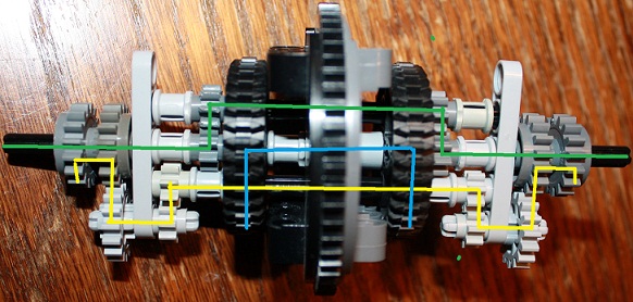

Here's how to do it:
get as many freely spinning axles through the turntable, then one ofter another get into the centre then lead them away to their functions:
hope you understand :classic:
I had actually thought of the 'yellow' and 'green' functions before, but hadn't figured out a way of getting the 3rd function accessible by another gear. Anyway, you found a proper solution! :wink: (although using modified parts EDIT: never mind!)

yeah kinda'
This actually looks a great idea, although I think the gray liftarms need to be more firmly attached to the 36t gears for this to work well. I like how you made the gearing symmetric on both sides of the turntable, which allows the 36t gears to spin without affecting the other geartrains at all (if there is enough friction on both sides).
