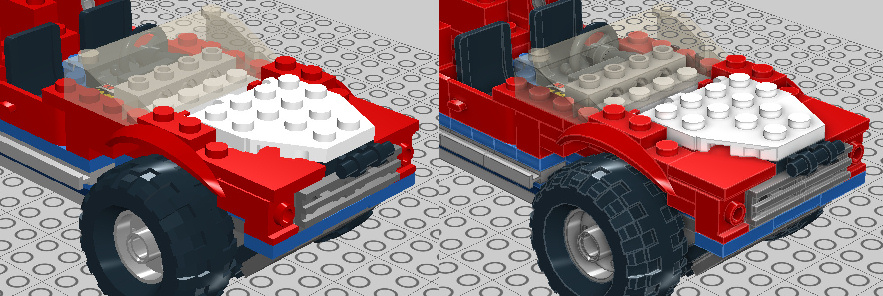

Part 1 - Turn advanced graphics ON
If you don't see the cool, advanced graphics in LDD 4, try this
STEP 1 - Turn on advanced graphics
If you don't see the advanced graphics (such as brick outlines, see image below) in LDD 4, first make sure you've turned them on. (Edit > Preferences). Outlines on bricks should be checked, and Advanced shading lever should be max to the right. NOTE: If you've got an older computer, you may want to only use the advanded shading and leave the Outlines turned off since outlines seems to be more heavy on the computer.
STEP 2 - Update drivers
If you can't turn on Outlines and Advanced shading because those options are grayed out, your first step is to update the drivers:
a) For Windows - Make sure that your DirectX drivers are up to date as this will also install the latest OpenGL drivers (which is what LDD uses). Download here
b) Update the graphics drivers. This is very important, since many problems are solved with updated drivers. Download NVIDIA here and ATI here. So how do I know which graphics card/chip I have? In Windows, Start > Run. Type in "Dxdiag". Look at the Display tab.
STEP 3 - None of the above works
If it still doesn't work, you've either got a too old graphics card/chip or there is a bug in LDD for that particular chip. Then all you can do is to either update the graphics card or wait for the next release of LDD where hopefully any bug has been fixed.
