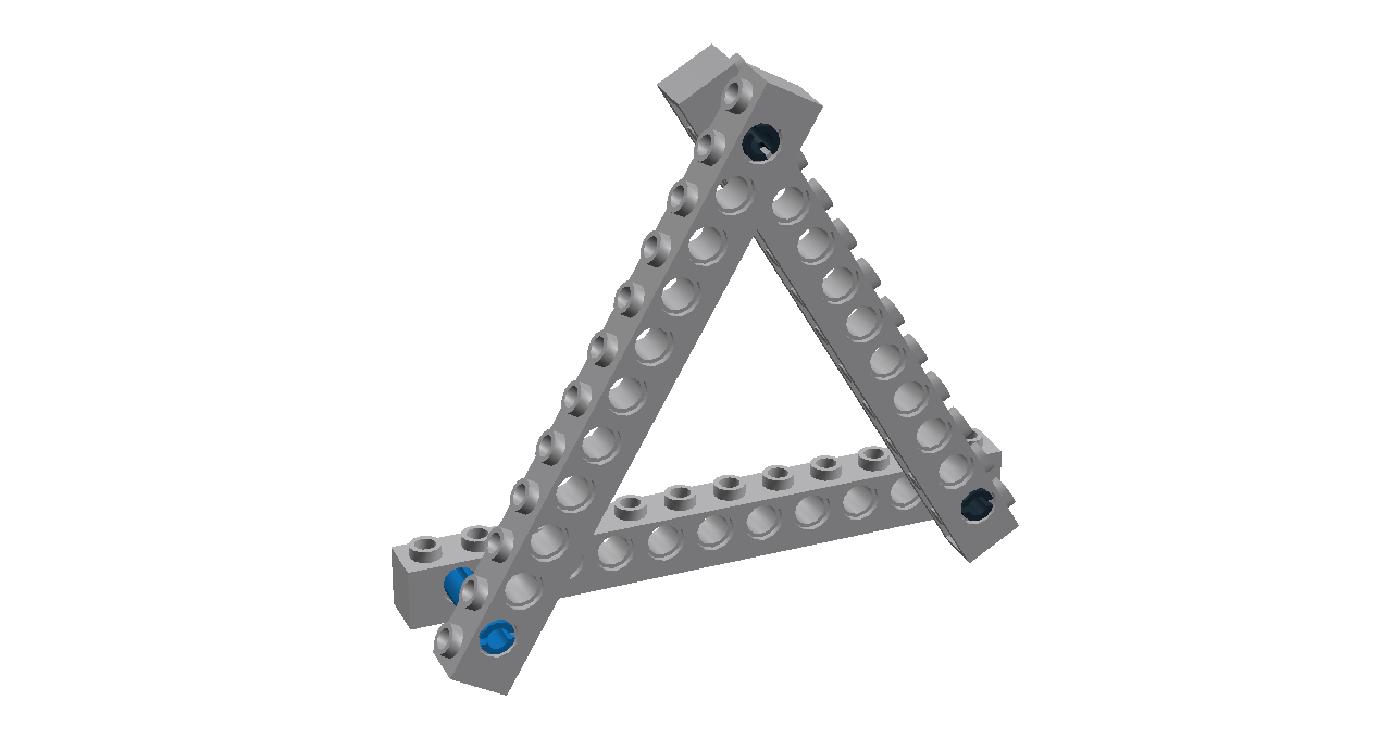

Posted 08 July 2010 - 05:55 AM
You can create 60 degree angles (which are effectively the same as 30 degree angles) by making an equilateral triangle with Technic bricks, too.  It may not be as convenient as the the aforementioned methods in some cases, but there are likely situations in which it would be useful.
Attached File  LDDScreenShot1.png   70.61K   0 downloads
