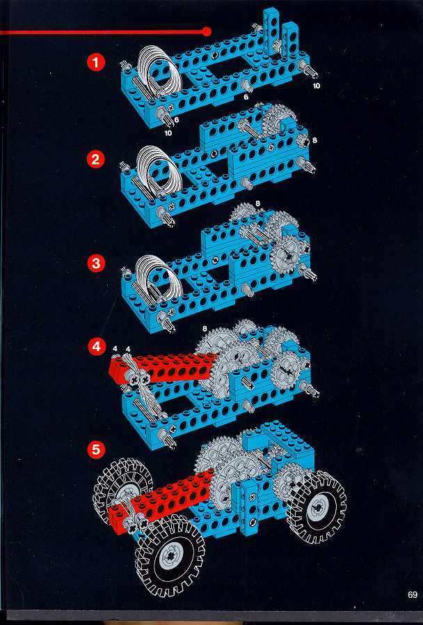

There's one in the 8888 Ideas Book.
Attached File  069.jpg   71.69K   142 downloads
This was one of my favourite childhood models to make.. lots of fun.. and didn't need many parts.
I think I remember modifying it a bit, to include a ratchet mechanism.. so you could just lift the arm up, without having to pull the wheels back.
