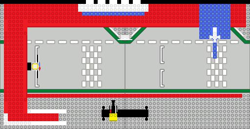

Well, I finally managed it I guess, hereby a gif for the 10027 Train shed (in the long version, not with the sheds next to eachother
Posted Image
--EDIT-- created a new version with better quality
