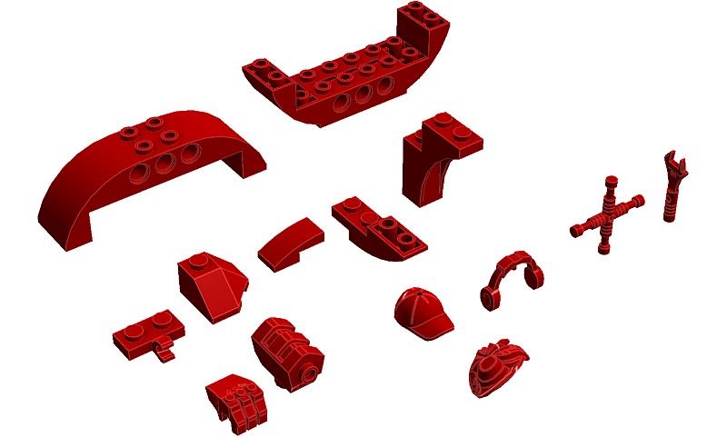

I learned via one of my Facebook groups that there are new Hero Factory and Chima parts there. I don't have access to my computer right now so I don't know the status on new colors or decorations. Hopefully Superkalle can fill us in on new parts, decorations, and colors before too long, and when that happens I will do my best to identify them. Overall, just the parts I've seen are enough to get me excited. :classic:
Share this post
Link to post
Share on other sites
This is by no means an exhaustive list. I'm not familiar enough anymore with the minifig accessory categories, and I'm certain there are many other new parts.

Just doing a quick look and it looks like:
  • all the collectable minifigs and parts. (series 1-10)
  • the Lego Friends accessories, pets (even series 1 and 2 pets)
  • more minifig parts and accessories then I realized. looks like all but 2H 2013?
  • I think new baseplates
  • new vehicle parts
  • some new city/town parts and accessories
  • maybe a few new castle building parts
  • new Technic parts
  • a little bit of everything else
Now this just what I seen at a glance. I might be wrong, I might be wright?

I'm conveying some info from the LDD Team:
The latest update seemed to be too large for some computers. A fix is being worked at.
The update contains about 180 new parts. See attached LXF-file.
About 20 bugs have been fixed, see list below.
Bug fixes
98102 COCKPIT cannot be lowered completely.
NOTE: fix also includes changed connectivity, so brick will removed when opening existing LXF and thus need to be re-placed.
85861 ROUND PLATE WITH HOLE does not connect to Technic holes
This elements is now becoming a System element, and thus this was changed
11272 CROSS BLOCK has too shallow x-axle holes
13269 ROOF FRONT cannot be placed back-to-back with another 13269
75542 and 75541 RAIL SWITCHES do not connect to other tracks
64022 FLEX RAIL does not allow full connectivity
Missing sliding functionality on 99061 LATTICE
Missing sliding functionality on 89519 LATTICE W KNOB and 11216 LATTICE W KNOW
64647 FEATHER has wrong geometry
10304 CHEST LID will not connect to 30163 COFFIN
87752 COCKPIT will not close fully
41750 LEFT SHELL cannot be placed next to 41749 RIGHT SHELL
93571 BALL CUP will not fully allow technic pin to attach.
10067 RING should not allow studs to attach from two sides
NOTE: will allow attachment, but only from one of the sides
4019 cannot fit fully into 32007
57528 will not allow x-axle through Technic hole
Minifig and some other parts cannot be placed inside 47847 WALL ELEMENT
40243 NEWEL STEP does not have cavity on underside
30158 RUCK SACK is not in its closed position
4623 PLATE W HOOK out of system
Connection forbidden between PLATE 1X1 ROUND (6141)and PIVOT JOINT W.
TECHNIC HOLE. (43889).
ReleasedBricks.lxf

Interesting! I don't recognize part 14301 FLEX TUBE 12M. It looks like it'd be most appropriate for a constraction or sci-fi theme, but I tend to pay fairly close attention to those at Toy Fair and don't recognize this part at all. That seems to be the only "accidental" part inclusion.

Oh my. I've just noticed in Superkalle's LXF... that little hinged sunroof from days of yore. There is hope for the old bits yet!
Share this post
Link to post
Yeah, 2348 and 2349 are finally there :laugh: . Too bad 4214 is still missing :sad: .
