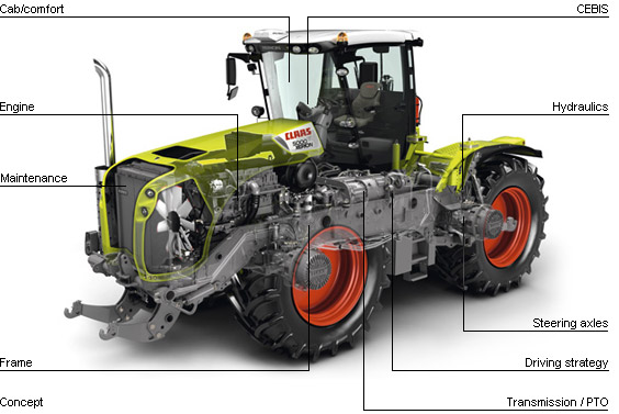

Well if it doesn't have a tow bar, make a 3pt hitch with a tow bar, adjustable height control.
Hi!
I tried a pneumatic 3-pt hitch on my moc, pretty tricky since the cylinders are not the right size:
Share this post
Link to post
Share on other sites
It looks really good, maybe you could try to it do like this
With the cylinders facing upwards, it might not be the same system as the original Xerion, but will be strong enough
EDIT: or maybe like the real one, which is pretty awesome (looks at the hitching point):
