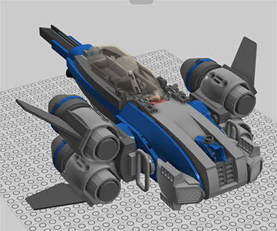

anothergol Posted June 28, 2015 It's for this ship, so yeah it'd have to be sturdy enough I'm afraid. The reason I need them flat enough is that I have no room in the body to hold them, there's a light brick and an engine as the cockpit will be motorized (chances are that it's gonna go very wrong). It works well as is, but it would be a pity not to have those boosters rotatable. But it looks better with them closer to the body. Share this post Link to post Share on other sites

anothergol Posted August 16, 2015 I've finally made pics of this MOC I had finished weeks ago. I eventually went for the rotary assemblies, works well. And the "motorized" cockpit works well as well, I should make a video, even though it's a fast & short anim. Yeah, the 61100c01 motor -can- be used for doors & stuff. http://www.mocpages.com/moc.php/417995 Share this post Link to post Share on other sites
rodiziorobs Posted August 16, 2015 Woah! It looked good in LDD, but it looks superb in actual bricks. Well done, glad you got the technical issues resolved. Share this post Link to post Share on other sites
