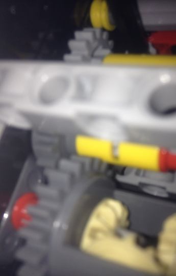

Guys,
My 10 year old is having some issues with his Unimog and is frustrated. I noticed two things:
1. When you push the Unimog gently forward, and let it go on a flat horizontal surface it rolls back.
2. The gear in the central diff seem to be rubbing on the yellow cylindrical tube (see attached file). Is this normal?
Help and tips (besides dismantling it completely :classic: ) are welcome.
Share this post
Link to post
Share on other sites
Guys,
Help and tips (besides dismantling it completely :classic:) are welcome.
1) How does the steering work? It looks like the differential was put in backwards, but if that's the case, your steering would be all messed up too.
2) Can you verify that the differentials in both axles have the ring gear on opposite sides, as illustrated in the renderings above?
3) Is the red bushing towards the front or back of the vehicle?
We'll go from there...
Edited to add question 3
Edited by dhc6twinotter
Share this post
Link to post
